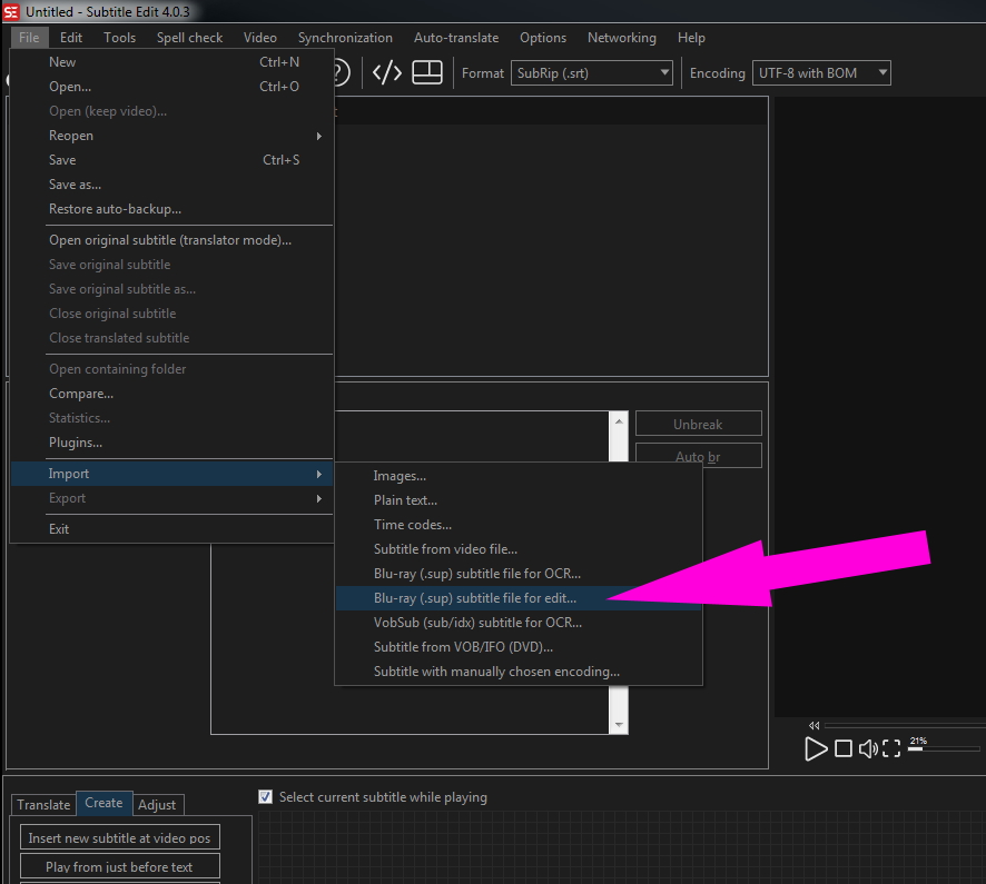

You don't need to go through the OCR process. Simply open SubtitleEdit and use:RAHRL wrote: ↑Sun Mar 10, 2024 12:06 pmI will give this a try. I.e. use SubtitleEdit to do the OCR on the subtitle and generate a SRT file. Then use that SRT in the Handbrake compression as an external subtitle file.
I never modified the position of the subtitles in an SRT file beore, to be honest I didn't even know it was actually in there.
Thx.
"File > Import > Blu-ray (.sup) subtitle file for edit..."
Then edit the position of any affected lines directly.

Sorry, I should have explained that you need to extract the subtitle track(s) from the .mkv file first.
There are many options for extracting tracks from .mkv files. You can use MKVToolNix with the MKVEXtractGUI-2 add-on, plus there are many stand-alone programs that will do it, as well as most video editing suites.
I use Inviska MKVExtract (no longer supported but I believe you can download it here).
Once open, simply drag 'n drop the .mkv file into the program, check the tracks you want, and click "Begin". It will then extract the selected tracks into the same folder as the source file.
Once you have the subtitle track you need, import it into SubtitleEdit as above and you will be able to adjust the position of the individual images.
You can modify each and every line individually, or you can change the entire file at once using "Tools > Alignment..." from the menu.
Once you're happy, remember to "File > Save as..." (I recommend saving under a different file name so you still have an unmodified copy).
Then use MKVToolNix to mux the modified subtitle back into the .mkv file (you can remove the original subs or leave them there so users can choose).
